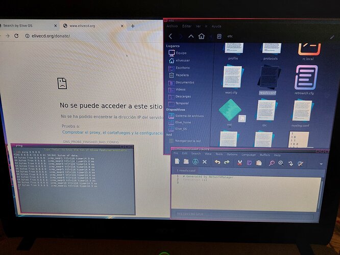

Hello again,
Effectively the file resolv.conf done different results,
First in 3.8.30 installed from zero:
Internet goes OK.
Second in default live 3.8.32 with kernel 6.0 in live mode:
Ping 8.8.8.8 seems goes well but no Internet available.
And finally I also tested live 3.8.32 with kernel 5.0 done the same result, ping seems OK but no Internet...
I'm completely lost in this affair...
Pinging 8.8.8.8 means that you do have an internet connection but that the resolving of names corresponding to IP adresses isn't working.
so editing /etc/resolv.conf and adding
nameserver 8.8.8.8
on the first line there, will solve the issue by using Google to resolve the names, after saving that file you'll be able to 'ping www.google.com'
