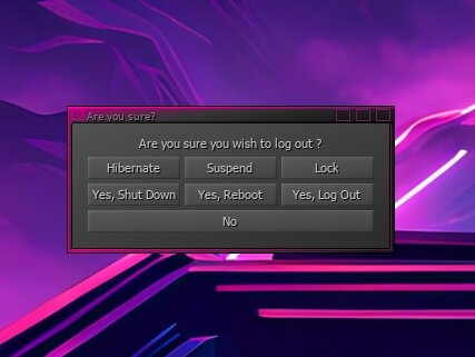

1. Reason -- Elive's interactive (yad-based?) exit menu seems to have timing glitches, namely where when you select say "reboot", the scripts will continue to run without waiting for your sudo authorization input. At least for me, this has led to stalled activity, AND if I click the physical power button on the laptop, it will go ahead and LOG OUT and return you to the lightdm greeter, which has a shutdown icon that does nothing. :unamused_face:

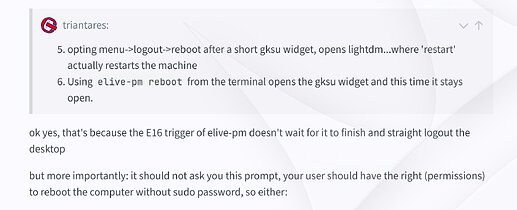

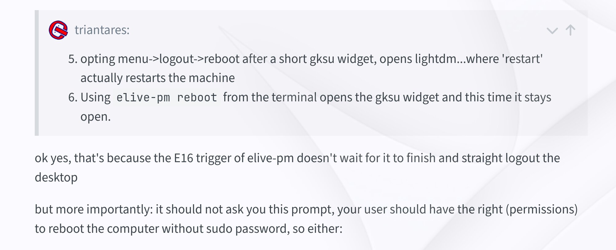

Suspecting this is on a Trixie on on openRc upgraded system, this bug has been noted.
Actually 'reboot' shouldn't require authorization and is an issue with how the various commands are handled in the base Trixie system.
The 'reboot/shutdown' does seem to work when using'elive-pm' directly from the commandline.
Yes, through 'usr/share/e16/scripts/e_gen_menu'

Hopefully, this will shut off (ha ha) the chances of you getting the yad menu dialog that misbehaves and just puts you back in the Elive login screen when you wanted to reboot or shut down the machine. The exit-elive script is modal and waits for sudo authorization before the elive-pm xxx command gets to run.

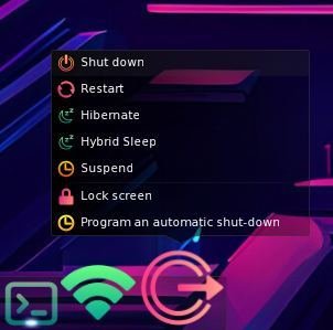

Okay, maybe a "final" note here (bwa-ha-ha!). Anyone who's explored Cairo-dock might know about its built-in "Logout" applet. It's COOOL !!!! ... but...but... it has some usability issues. When it's enabled, here's what the exit menu looks like:
Nice ! -- no? Very nice, in fact. The Shut down, Restart, and Suspend actions work like a champ. Did not try the hibernation items but have no reason to believe they don't work. HOWEVER, the "Lock screen" menu item is a NOP. Does nothing. Nada. You'll also notice that there's no bona fide "Logout" menu option. Say WHAT???? Sure, you can open a terminal and enter "kill -9 -u $USER" and you're outta here, but then why would we need all these nice menus? For what it's worth, you can configure the logout applet to LOG OUT via a middle-mouse click, which (1) won't be obvious and (2) is awkward.
I have no idea if the reboot/shutdown/suspend/hibernate actions are integrated with Elive such that they invoke the proper, anointed, actions via elive-pm. I do know that the config file for it has a fallback invocation of the (ahem) dreaded problematic yad menu:
...this is the menu, where if you select the reboot or shut down menu items, it results in a chaotic logout process with an authorization (sudo) prompt that quickly goes away and you're thrown back into the Elive login screen. Not the kind of shutdown you wanted!
That being said, the Cairo-dock "Logout" applet is a really nice, really cool addition to your panel -- IF you don't mind that the lock screen doesn't work and the bona fide logout menu item and capability (the easy one!) is hidden or worse, unavailable.
