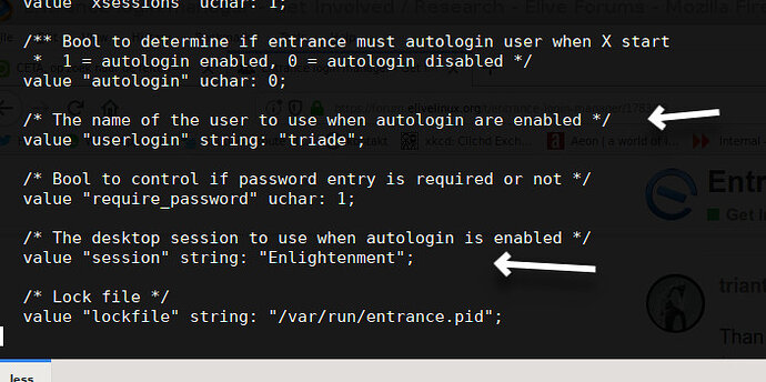

Than you have not activated "autologin" using your username and prefered DE in "/etc/entrance/entrance.conf".
  • Once you've done that and rebooted you'll have the previous session remembered and have the shutdown'reboot options greyed out.
  • After disabling autologin again and rebooting, everything will be back as it was albeit that the now the previous choice will be remembered for that user.
mmm i set autologin boolean value to one and i got 1€ coin skinned penguins as user icons instead of autologin :joy: still pre selecting cairo dock
In the next lines after the boolean you have to enter the username and wanted DE. (E16 or Enlightenment)
In my case user "triade" and DE is "Enlightenment"
