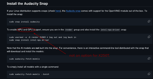

It looks like the 'snap' option might work as the pluginyou expect it so try that (in impermutable mode first)
the snap install is easy enough but:
As mentioned, your hardware probably isn't up to it.
At the least you'll need Intel Core Ultra processors :shocked:
