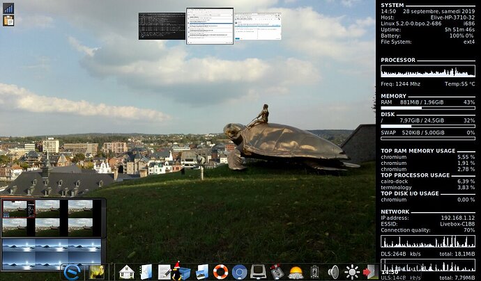

BTW, I doesn't know why, but I miss a personal background and for some unknown reason is missed at every system restart, I must activate it every session because I got the default alpha background...
How to fix it?
P.S.: Is the Jean Fabre "Searching for the Utopie" sculpture, site at Namur's Citadelle, in Belgium, picture taken last Tuesday 17th September 2019
That is strange behaviour. How do you apply your personal background?
I copied the picture in /home/luis/.e16/backgrounds/ and then right-click in a clean desktop area -> settings -> Background
If I do right click into image and "use as background" nothing happens, and if I go into E16 backgrounds menu without pass first by E16 global setting box nothing happens neither...
that should work and be kept despite reboots and new logins :thinking:

Yep, but it doesn't work.... any new start I must look for this background again (those turtle has an special signification for me and it was related with a story concerning my new job that I'll related in coffee corner)....
On a reboot is the picture still in .e16/backgrounds or do you have to put it there again?
Is still there...
Then I really don't know what could be the problem other then that you don't click apply or save in the background settings menu.
I tried both, but the issue remains there....
for conky? check the alpha / composite / argb settings in ~/.conkyrc (this is auto when creating a new desktop conf)
I doesn't know what you did, but now issue is fixed after several apug.... :+1:
