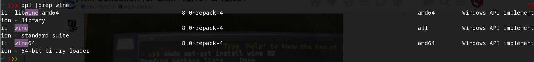

To find out if and what version of wine is installed do:
dpl | grep wine
Which will give an output similar to this, also showing what you have there. (I've got 64bits)

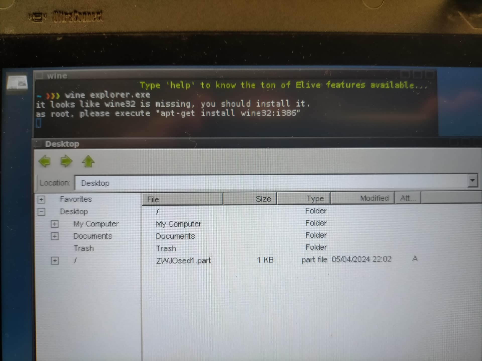

It appears wine is installed but it just gives the same message as you. It says I should install it. Ive been trying for a year now to install wine I have never succeeded. After days of trying everything I give up. Then in desperation I try again.
so what was the "dpl |grep wine" output?
and what happens if you use "wine explorer.exe" like in my example?

  • first screen shows that you have a 64bit OS running there...so that's good.
  • second shot shows 'explorer' running ... so 'wine' is installed and running.

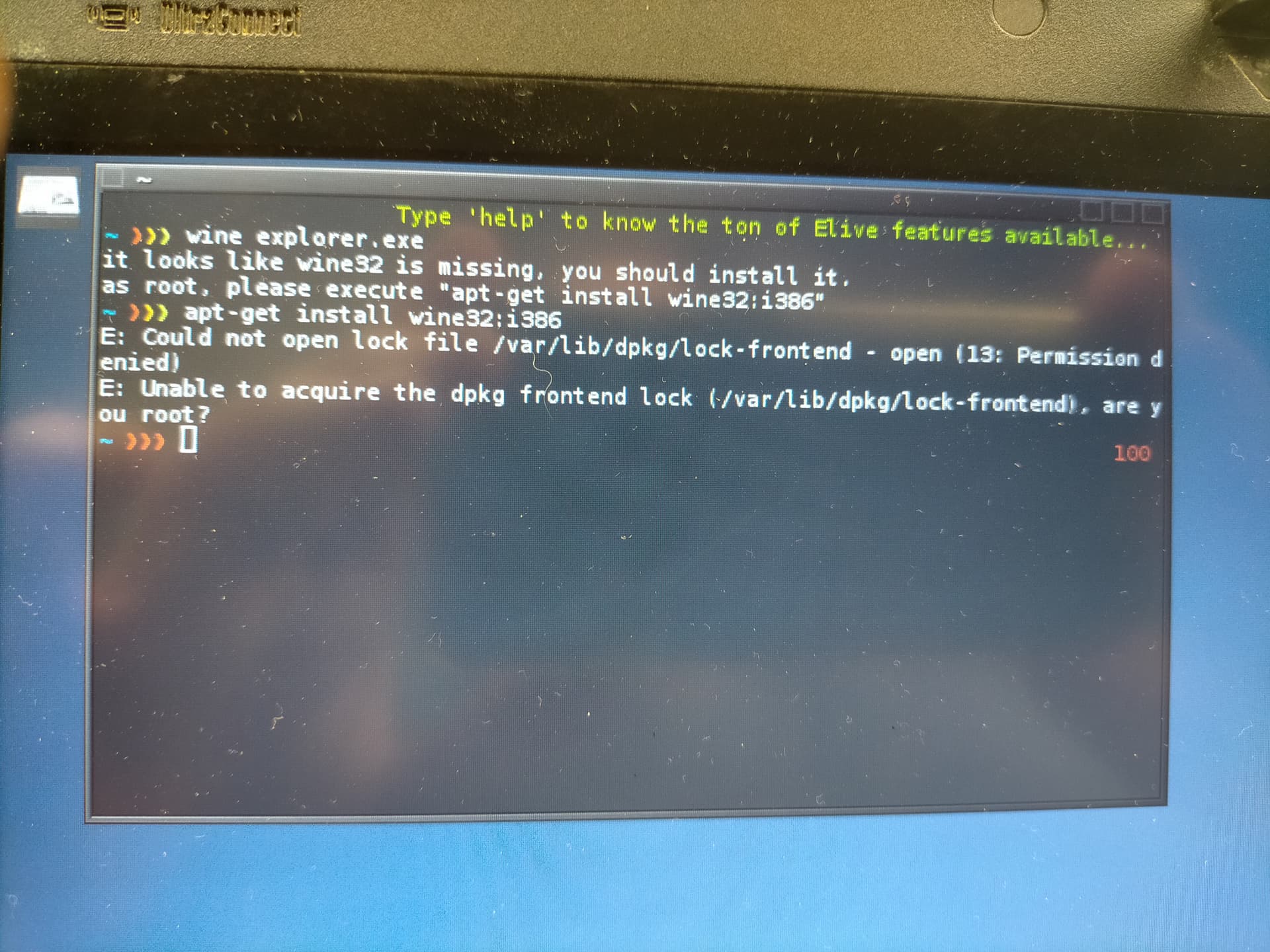

  • third shot tells you that you need 'sudo' privileges for "apt-get install" but ..... will (if you do use it) also tell you that 'wine32:i386' does exist. Don't add the ":i386" there and preferably use 'apui wine32' if at all.
    *This istalling wine32 will probably render wine useless but you can try. If running 'wine explorer.exe' doesn't work, remove the package with 'apr wine32' and try installing 'wine64'
