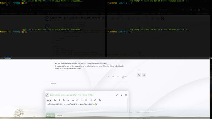

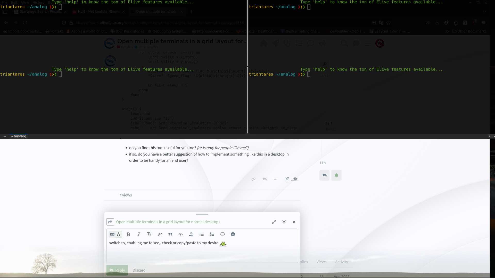

Here’s the result I had while testing:
Considering guake does everything other terminals do (like splitting and adding tabs) it's sole strength lies in it's availability as an overlay on any screen or monitor you want or need. It's always at your fingertips.
The drop-down appear/disappear option using F12, even if it's fullscreen. :applause:
It just moves along with you as you go from one monitor to another or from virtual-screen to the next, getting out of the way when not needed and back up with a touch of the key. That's gold!! :w00t:
@Thanatermesis I wont be making another video like the previous as it is fairly difficult to show this guake-strength without mentioning "and now I hit F12" all the time, to clarify what's going on .... and even that is a shitty solution.
