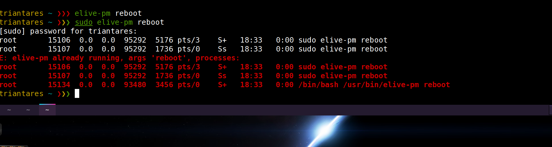

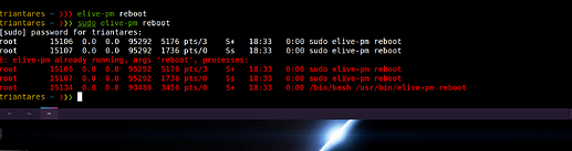

elive-pm doesn't require / should never be run with sudo, is meant to be run by user
if you add an "set -x" to the tool you can see what the code is doing actually, but basically for this case: it does a reboot only if there's no other processes rebooting or elive-pm already running, seems like you had a ghosted elive-pm ? (check it with ps aux, etc), your machine is a bit strange, so i dont have these issues :joy: but i think that the issue can come because you added / created your user without privileges (checkboxes in the user-manager creation), i think thats the culprit of the issue :thinking: you can experiment with these details by creating new users and trying with them (which of course will use the newer default settings commited in elive)
Yeah, either the one from the betatest upgrade or from trying the menu->system->reboot.

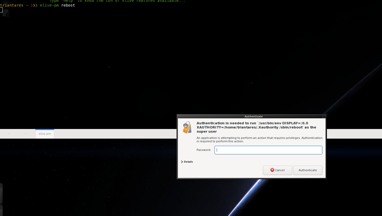

  5. opting menu->logout->reboot after a short gksu widget, opens lightdm...where 'restart' actually restarts the machine
  6. Using elive-pm reboot from the terminal opens the gksu widget and this time it stays open.

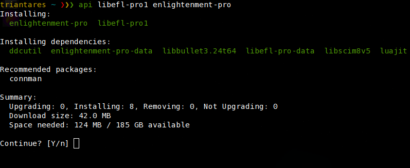

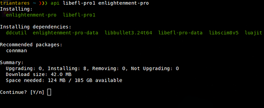

  1. I (re)install 'enlightenment-pro' which clearly has been removed including dependencies:

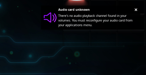

  4. On every E27 login I get the pop-up to choose the sound card and ultimately that it was not found. But sound does work. :thinking: In E16 there's no message and sound works.

ok yes, that's because the E16 trigger of elive-pm doesn't wait for it to finish and straight logout the desktop
but more importantly: it should not ask you this prompt, your user should have the right (permissions) to reboot the computer without sudo password, so either:
  • you created the user without permissions (which checkboxes you selected ? i always enable all of them in my tests)
  • your system is not well configured to give him these permissions
so the gksu is doing its job for the users that has no permission (thats very good, expected, and well working), but the question is why your user cannot reboot (is this an expected/wanted behaviour?)

this message is from setvolume, run this:
export EL_DEBUG=3
setvolume defaults
if you don't see anything, add an "set -x" at the start of the script and try again, try to catch what is the thing that makes it -think- that audio is not working, so we can fix it (or just paste the set -x contents in a pastebin website so i can analize them and fix, that's more fast)

mmh, probably "setvolume" deleted your previous audio card configuration trying to reconfigure it (because it detected that your audio card was not working)

  • The noted issues (including the removal of 'enlightenment-pro') are only there after using init-switcher to move to openrc.

  • The "brower-on-ram" feature was not activated on any browser.
  • "elive-pm" issues only exist on openrc not with systemd.
