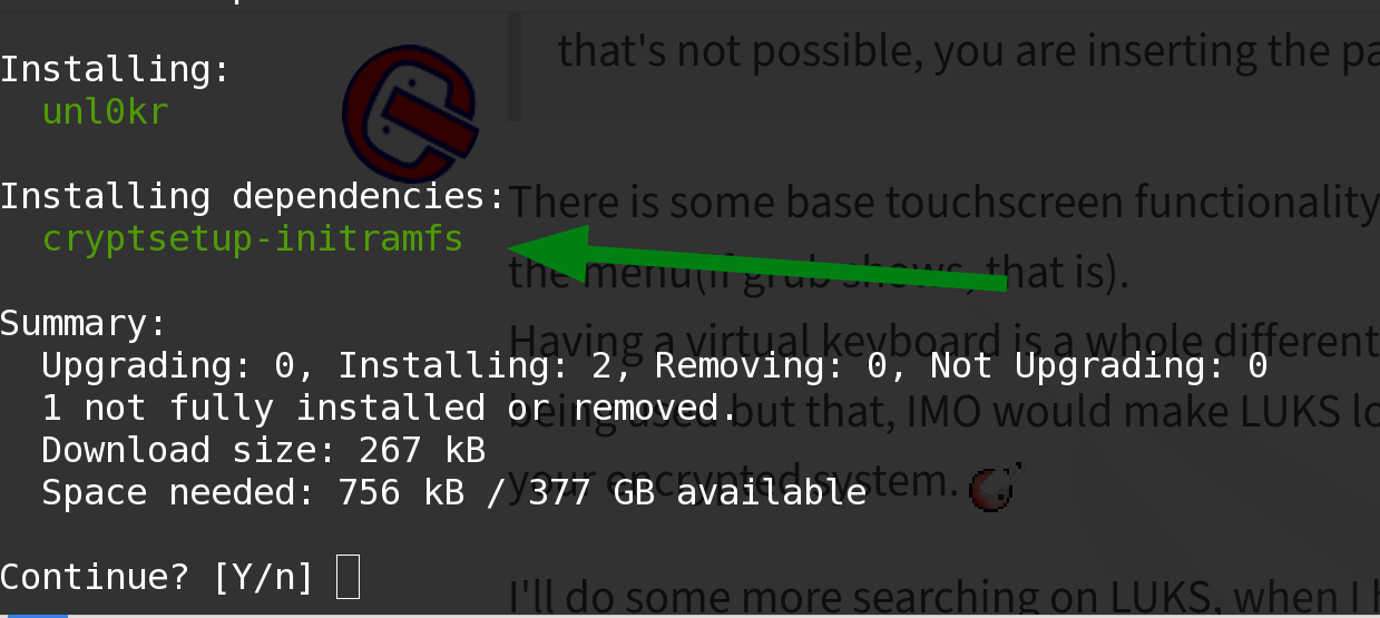

'unl0kr' looks interesting enough and is available in Trixi repos.
I don't have the tablet available ATM so maybe I'll see what it gives tomorrow ( is use my lunch break for that :innocent: )
It looks promising on the install prompt on my workhorse thinkpad.
Which after hitting 'Enter' gives:

and tried installing 'unl0kr' again but:
I get this"
Summary:
  Upgrading: 0, Installing: 0, Removing: 0, Not Upgrading: 0
  1 not fully installed or removed.
  Space needed: 0 B / 377 GB available
Continue? [Y/n]
Setting up initramfs-tools (0.148.4) ...
update-initramfs: deferring update (trigger activated)
Processing triggers for initramfs-tools (0.148.4) ...
update-initramfs: Generating /boot/initrd.img-7.1.3+deb13-amd64
I: The initramfs will attempt to resume from /dev/nvme0n1p2
I: (UUID=430db896-16e5-4d27-9134-bebabf2cf6ca)
I: Set the RESUME variable to override this.
zstd: error 70 : Write error : cannot write block : No space left on device
E: mkinitramfs failure zstd -q -9 -T0 70
update-initramfs: failed for /boot/initrd.img-7.1.3+deb13-amd64 with 1.
dpkg: error processing package initramfs-tools (--configure):
 installed initramfs-tools package post-installation script subprocess returned error exit status 1
Errors were encountered while processing:
 initramfs-tools
Error: Sub-process /usr/bin/dpkg returned an error code (1)

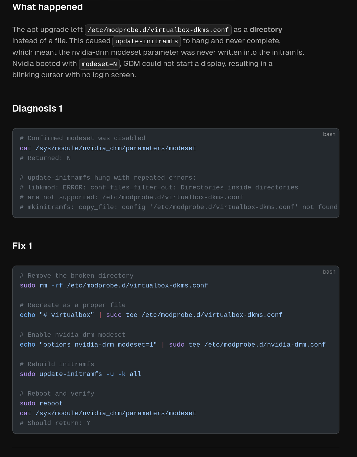

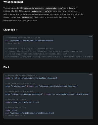

What I did come across is that this little modprobe thingy might be at the root of the nvidia issues in https://forum.elivelinux.org/t/trixie-upgrade-betatestings
