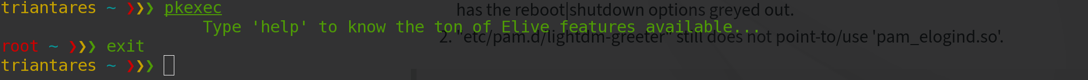

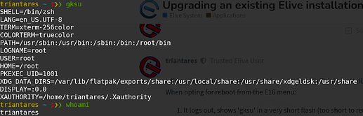

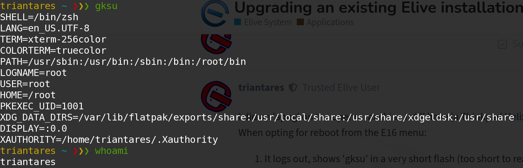

'gksu' and 'pkexec' in a terminal have different results.
gksu , after entering password gives:
Whereas 'pkexec' drops me straight into a root-session, quasi 'su'
I don't know what ('gksu' or 'pkexec') the DE menu options uses but I think it's not the right one. At least not in combination with a GUI

Running either one from the terminal works fine.
It's just that 'shutdown' and 'reboot from the menu apparently make it appear (it shouldn't appear at all IMO) and then logs out into 'lightdm'
