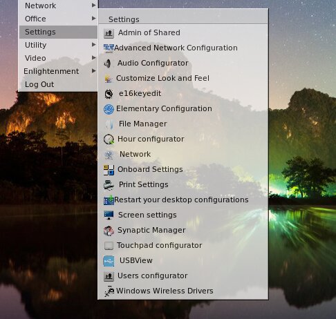

Added the configuration of the menus in the github repo under fancy-menus.
They are of course based on my own menus, which might have some entries yours don't.
In that case they'll be missing an icon. :grimacing:
If you want to test just clone (or download the .zip and extract) and run the "install.sh" in the "fancy-menus" directory. Read the ReadMe for more.

Yeah, apparently e16 menu cannot handle .svg icons so I replaced those with .xpm ones.
Tks !
I installed it ( "fancy-menus" )
Working great and look better
Yeah, but somehow it all gets lost if you chose to "restart your desktop configurations" from the settings menu.
Not sure exactly what command that is (maybe some weird skel stuff) but it recreates everything back to the default options including the removal of all personal stuff like backgrounds, settings themes, icons, the whole shebang.
Ultimately the "light" stuff will need to be installed in /usr/share/ or generated by Elive but I haven't found (yet) where @Thanatermesis keeps all that hidden.

This is what it looks like when doing it from the theme itself :nauseated_face:

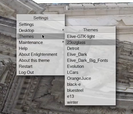

In fact the menus are there, they just don't show.
So if you want out, i.e any other theme:
"right-click" on your desktop, which'll show "settings", then arrow down twice andarrow right to show "themes" and arrow down twice (onle once choses GTK-light" again) and hit Enter.
This is what the menu looks like if it works:
