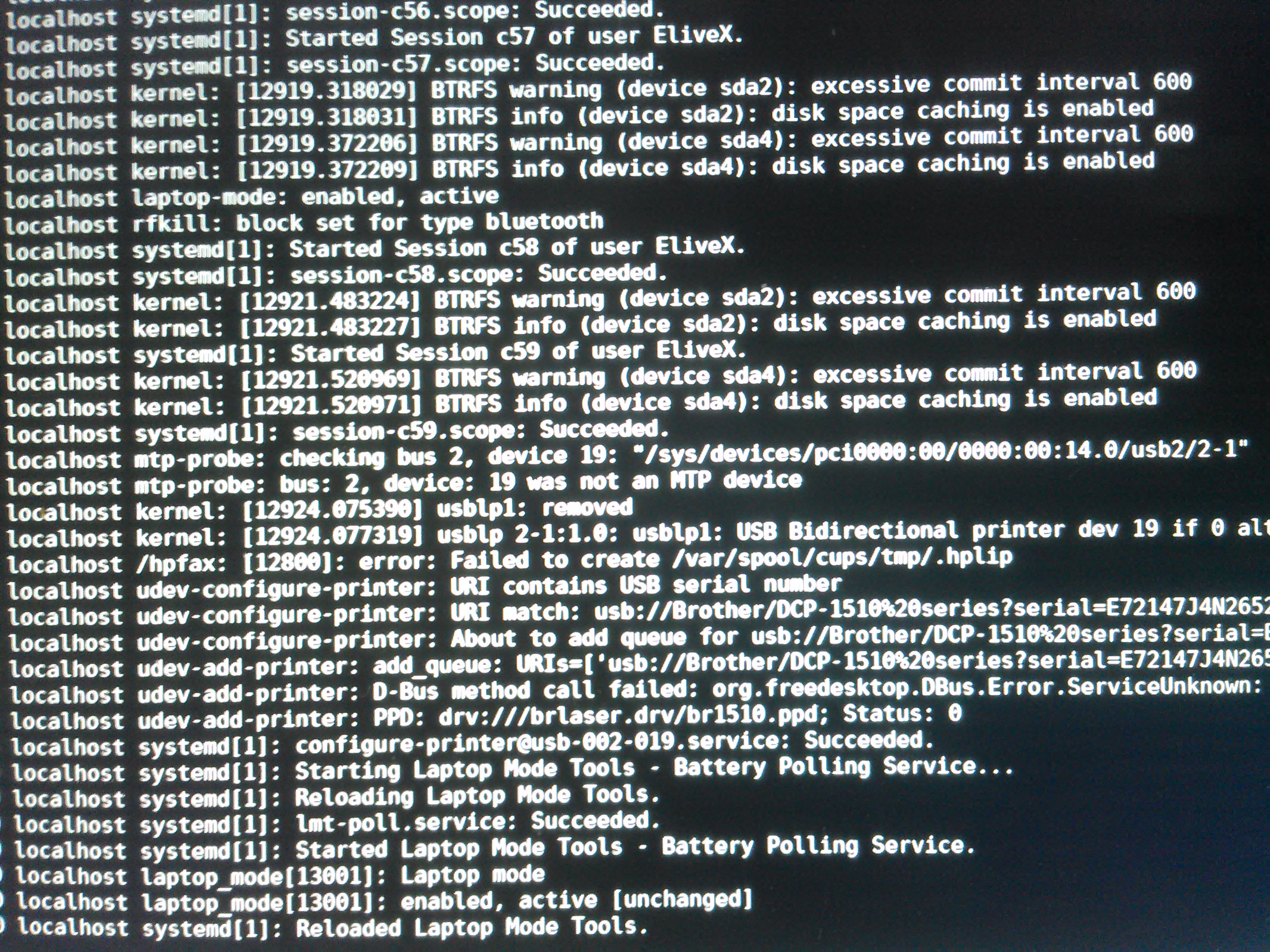

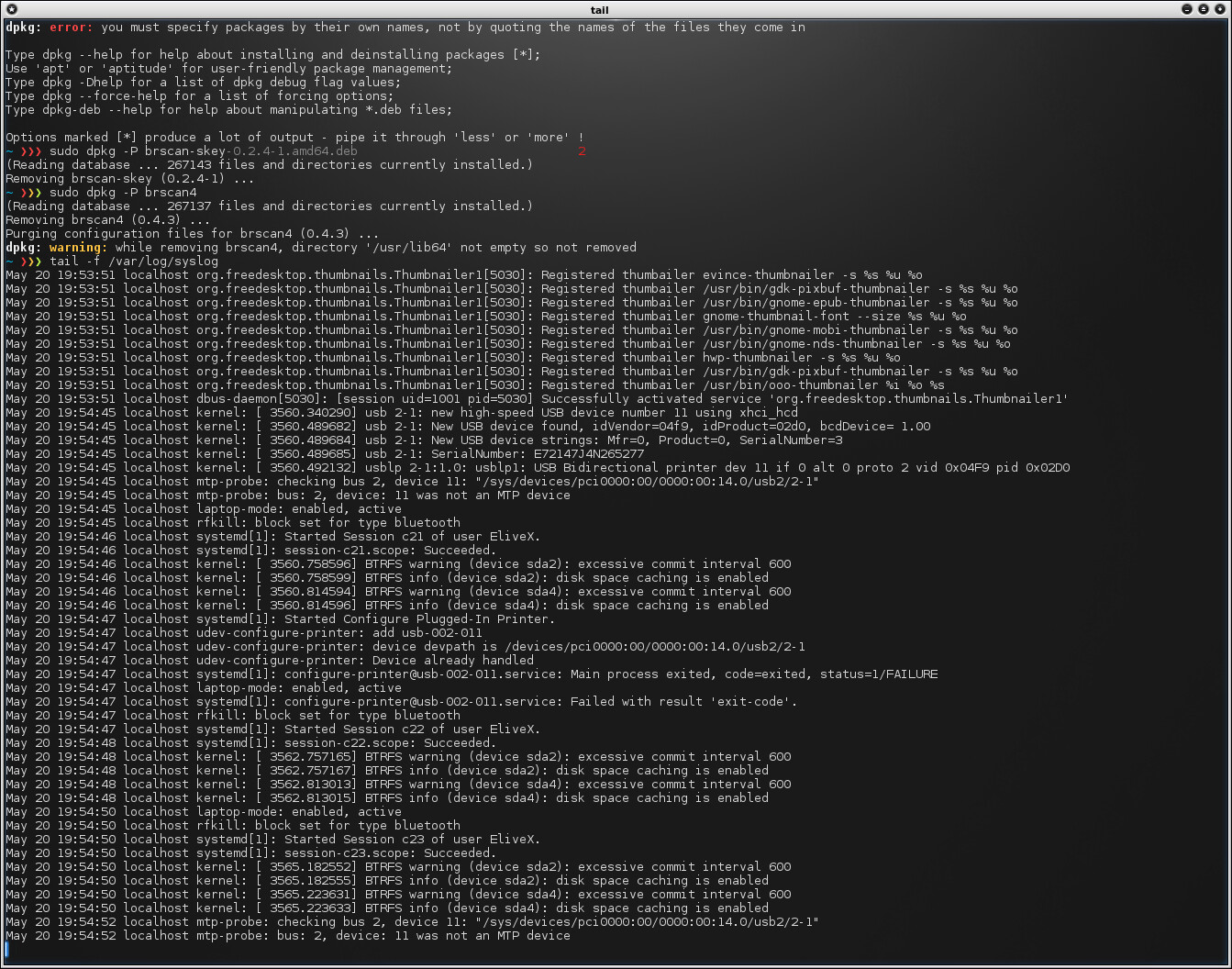

Just tested the Brother dcp1510 over USB. Works fine when plugging in and prints like a charm. :applause:
The scanner is not recognized though. That required installing brscan4 and brscanskey deb packages ....which went without a hitch using " dpkg -i"
I got them off the brother site a while back. If you want them I can put them up for you. Together rhey're not even 1 mb. I used version resp. 0.4.3-0 and 0.2.4-1
I improved a bit the ram usage for the next build, but you should have more than enough with 1gb (my virtual machine is already set to only 1gb), so you should have another problem :thinking:
, try to run "sudo htop" to see if there's a process stuck / consuming, and how much ram is using
so bad! try removing the brscan packages (apr --purge) and with the scanner connected, try to reboot your machine and wait 5 minutes on desktop :thinking:
I had "tail -f /var/log syslog" running. You can see udev doing the printer but not the scanner.
I waited a while, tried "simplescan" --nothing found!, installed "xsane" same result. Rebooted with printer connected, still no go.
Then installed both debs and scanner is recognized. The pic showing syslog and the scanner recognition is too unsharp to be helpfull, sorry. Still haven't mastered the screenshoot epplet (it's just too small) and don' t have prntscrn key, so taking pics with my phone.

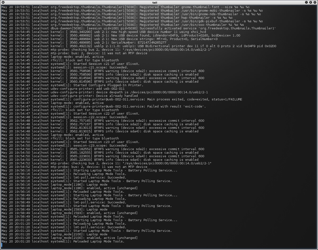

Didn't disable elive-health but wairted nearly 10 minutes. As you can see on the screenshots the printer is fine but no scanner.

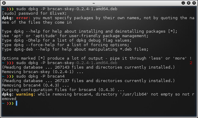

The purge (I sometimes get the impression you don't believe me :happy:)
The first shot, connectingthe printer:
6|610x456](upload://biD8ZyeeIdABk1mJHNG
about 10 min later (I kept tail -f running):
Then let SimpleScan look for a scanner (I scanned a page manually to make sure the printer didn't sleep):

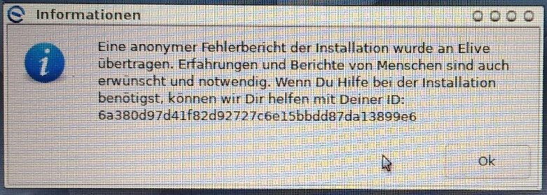

First I deleted all from the harddisk with gparted and put gpt with ext4 on to it.
Installation started
Installer update successful
option with
Automatic / ext4 / no encryption chosen
build-in HD activity light became active for 20 sec – stopped
Dialogwindow appears:
„Information“
„an anomyn report was created, bla – blaaaaaaaaaaaaa see image for details
Result:
Failed
Suggestions ?

Yes I believe you :slight_smile: but steps must be clearly said to not avoid them :slight_smile:
BTW I remove packages with apt instead of dpkg:
apr --purge packagename

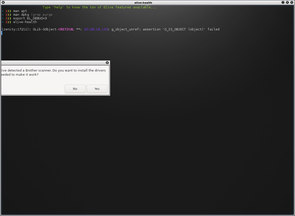

Ok let's try this, with brscan package removed, and scanner connected, run this and wait the command finishes:
export EL_DEBUG=3
elive-health
not important, and also I removed these useless messages for the next build

Installed it with dpkg so purged it with dpkg .:innocent:
With the printer connected I suspect.
scanner (i assume is a combo with printer)
the command just finishes without happening anything ?
show me the result of lsusb
