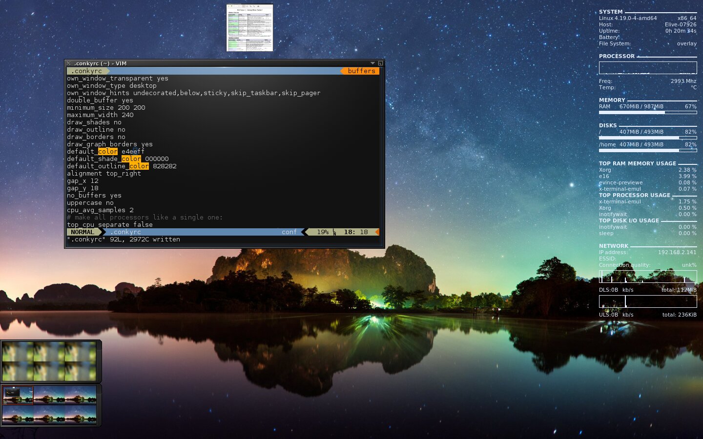

Using a less claustrophobic wallpaper.:sunglasses:
Selected these 2 ones, for the first and second vdesktop
