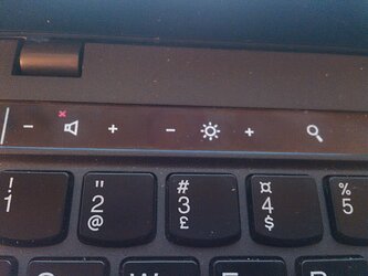

;My brightness up and down keys are not recognized using e16keyedit.
I don't mind manually editing .e16/bindings.cfg but have no idea how I can enter my 2 keys.
"showkeys -k" gives 225 (up) and 224 (down).

If I do showkeys -s I get "0xe0 0x54 0xe0"for 225 (up) and "0xe0 0x4c 0xe0 0xcc"for 224 (down)
kupfer key = 0xe0 0x0b 0xe0 0x8b for 120
search key (next to up on picture)= 0x9c for 217 (initiates gnome-search-tool, but isn't installed)
