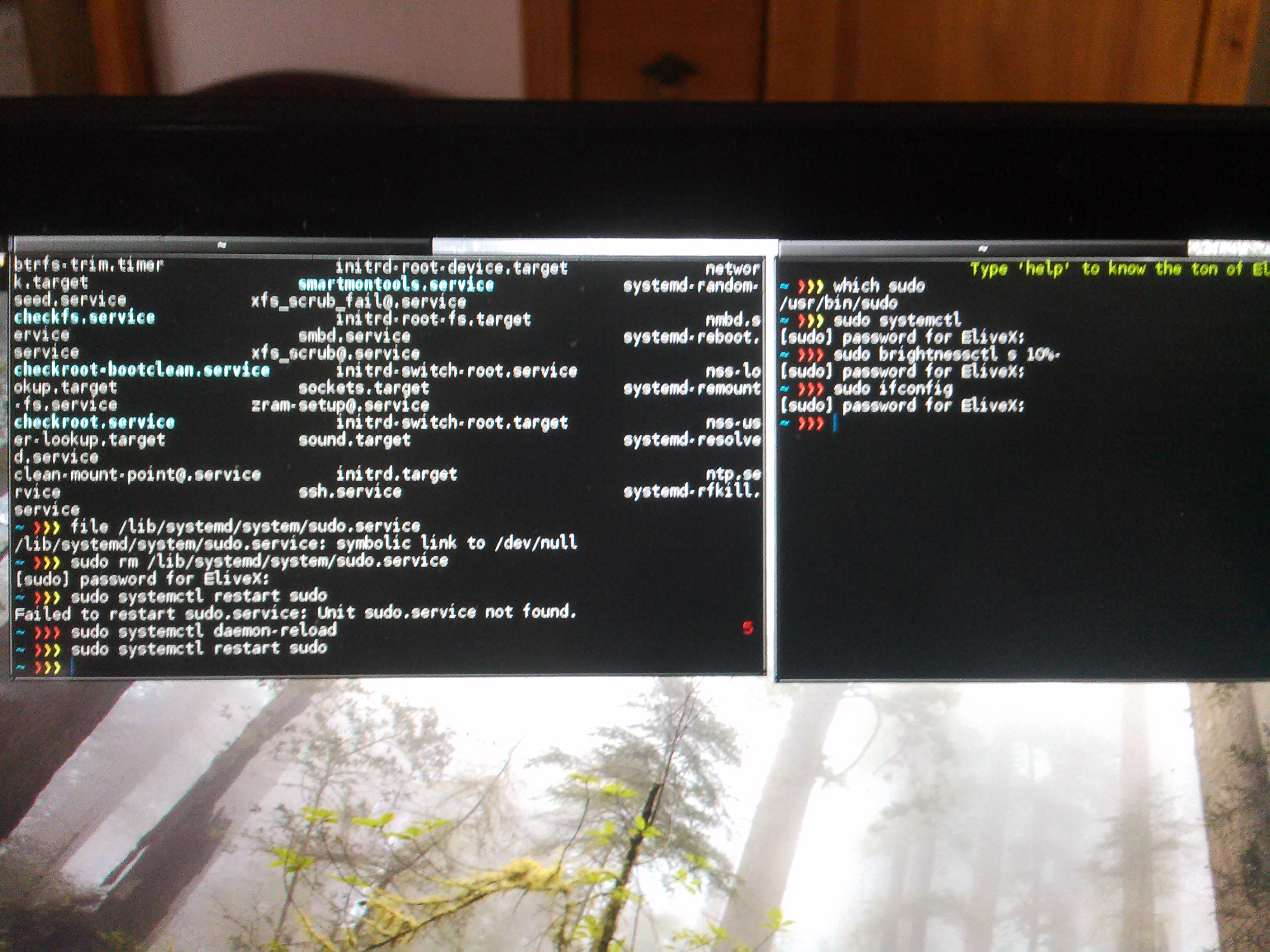

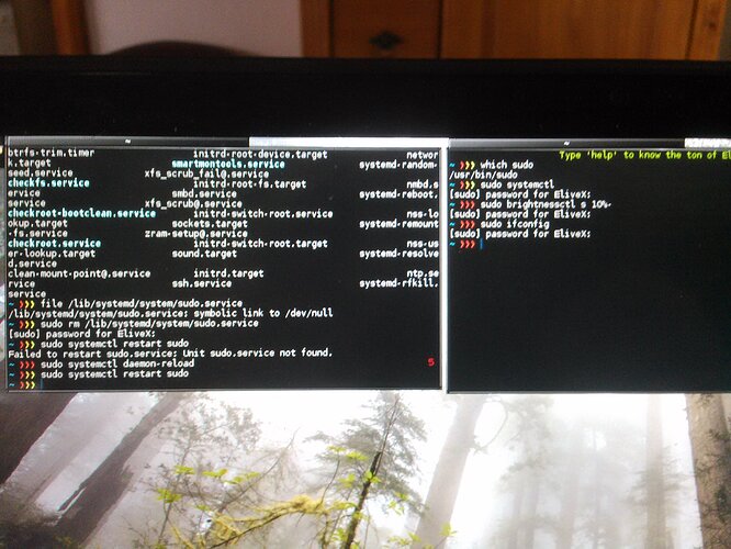

Wait @triantares, maybe the issue is with systemd,
sudo service sudo restart
this command is backwards compatible, but is not the correct one for system, it lacks things, like, if the daemon cannot be restarted it should tell you that! instead, it just looks like it is restarted. In systemd you should use this instead:
sudo systemctl restart sudo
but here i have it "masked", this means the daemon is not running? no sudo ? :confusing: i have ifconfig working too, but if im not wrong, when you change a daemon setting (editing files like the sudo ones) you need to:
sudo systemctl daemon-reload
or... i dont know much about systemd, but maybe you are using the old provided sudo configuration and thsi is why not works
btw, you can unmask sudo too !

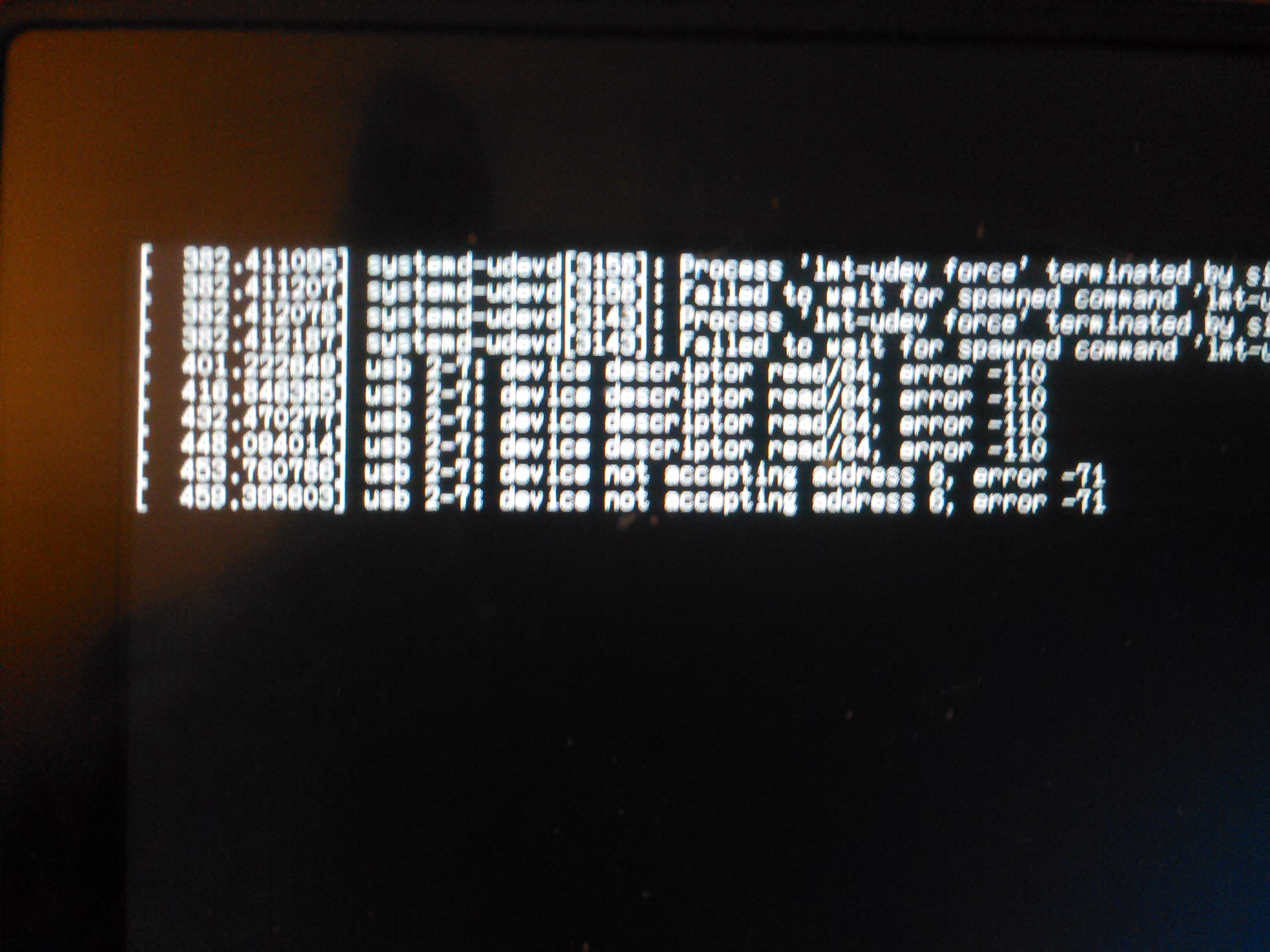

it shows errors in your HD, again the problematic cable? (well, it dont says HD, it just says error usb)

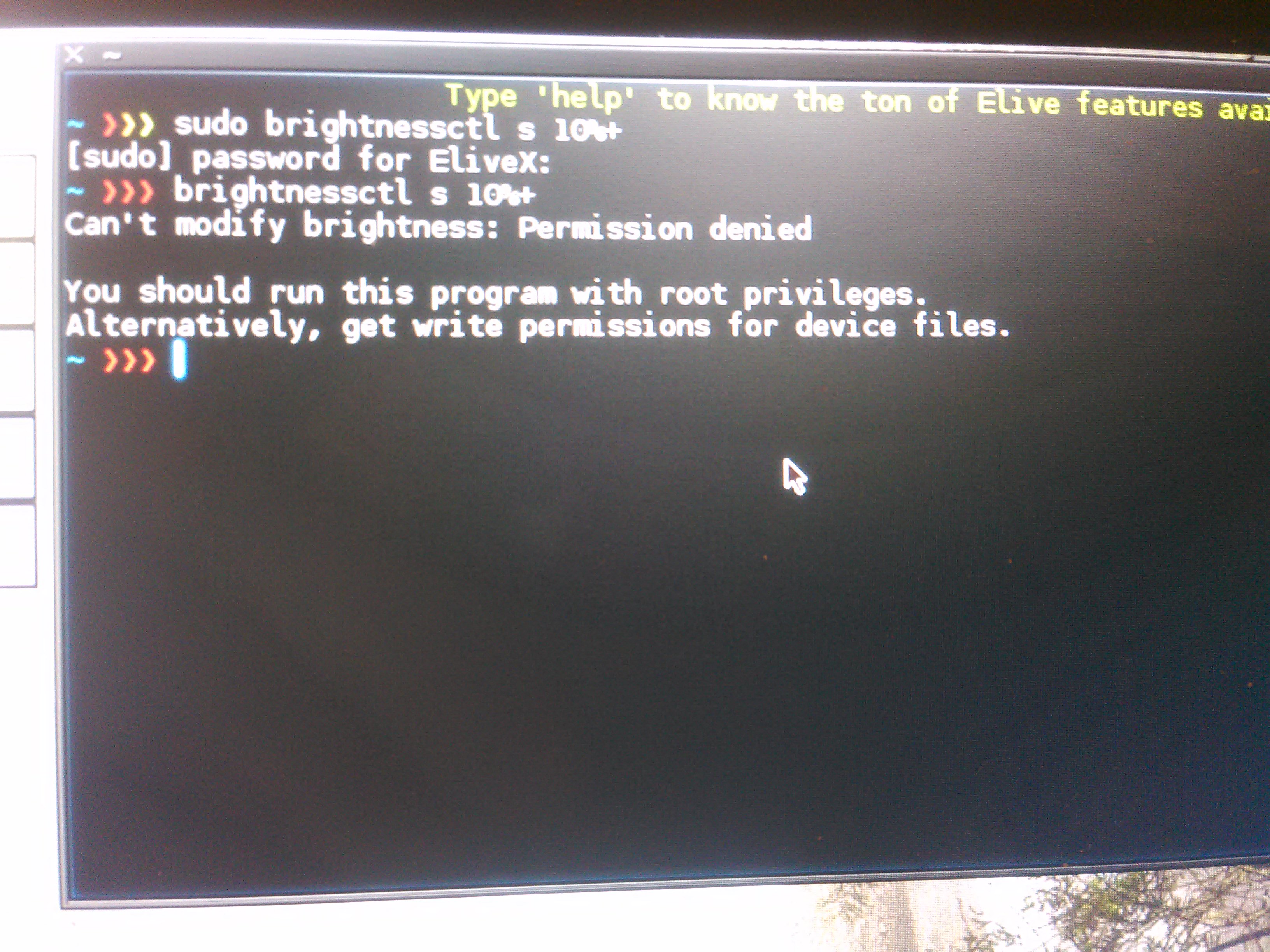

So again, your goal is "sudo brightnessctl" (working without asking password)
What about calling it with the full path? like:
sudo /usr/bin/brightnessctl
same problem?

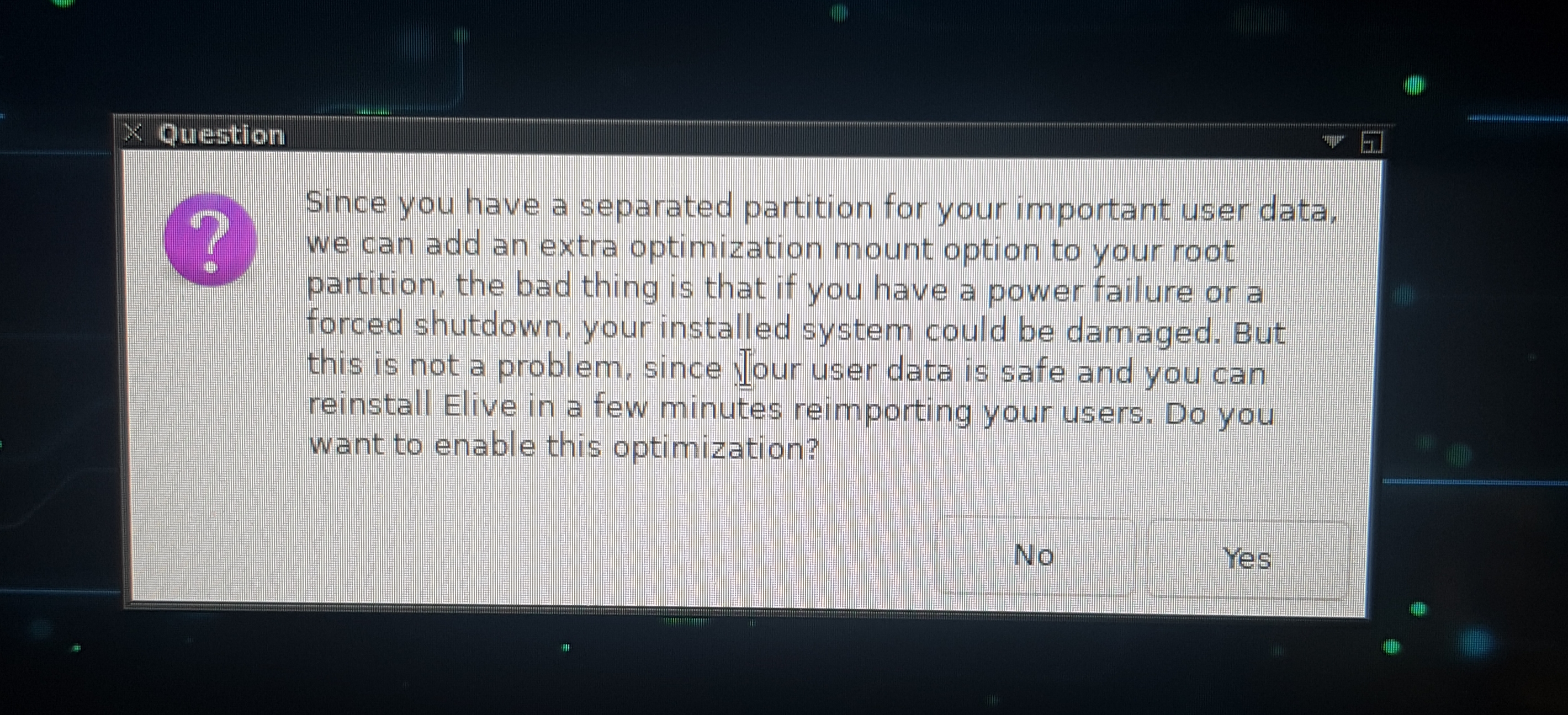

Really? hum.. this is interesting, this message is only for add a mount optimization option, to me sounds like a coincidence but who knows! more exactly it adds the option "data=writeback" for the root partition in /etc/fstab :thinking: maybe i should just remove this "feature" :thinking:

Changed from:
The installation will take a while to finish, in the meantime, would you like this project to continue to exist?
to:
The installation will take a while to finish, in the meantime, please consider supporting our work so we can keep Elive alive
Did you have seen the donation message appear twice or only one time ? @jfbourdeau reported it before that was twice and I don't know if my recent changes fixed them :slight_smile:

after booting said laptop again I now have " sudo ifconfig" asking for the password again, just like brigtnesssctl and rfkill ....... so somethings definitely wrong there.
It' s not brightnessctl or the keys it' s the way sudo is handled by systemd, methinks. :thinking:

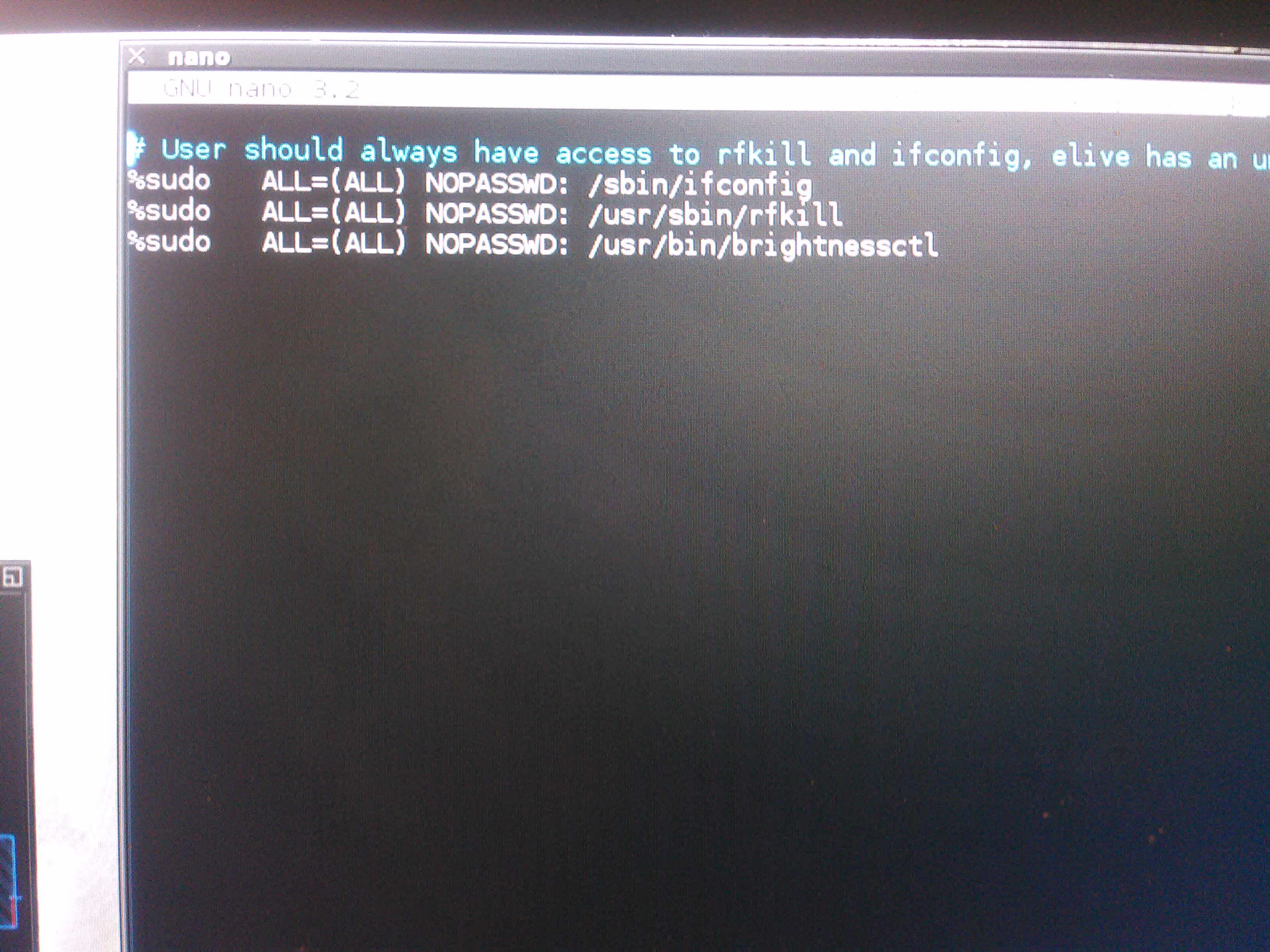

dded /usr/bin/sudo to the conf file, after unmasking service.sudo and reloading and even rebooting,
The picture is the howto. :mask:
But still: No joy!
That only leaves using " visudo" to alter the main sudoers file, evne if it' s only to test.

yep, you need to run sudo with these commands and see that doesn't asks for password, your files are correctly configured but maybe your sudo daemon is not running, systemd probably, try to unmask and to restart? i dont know it is masked on my machine too (but it doesn't asks for passwords for me)
