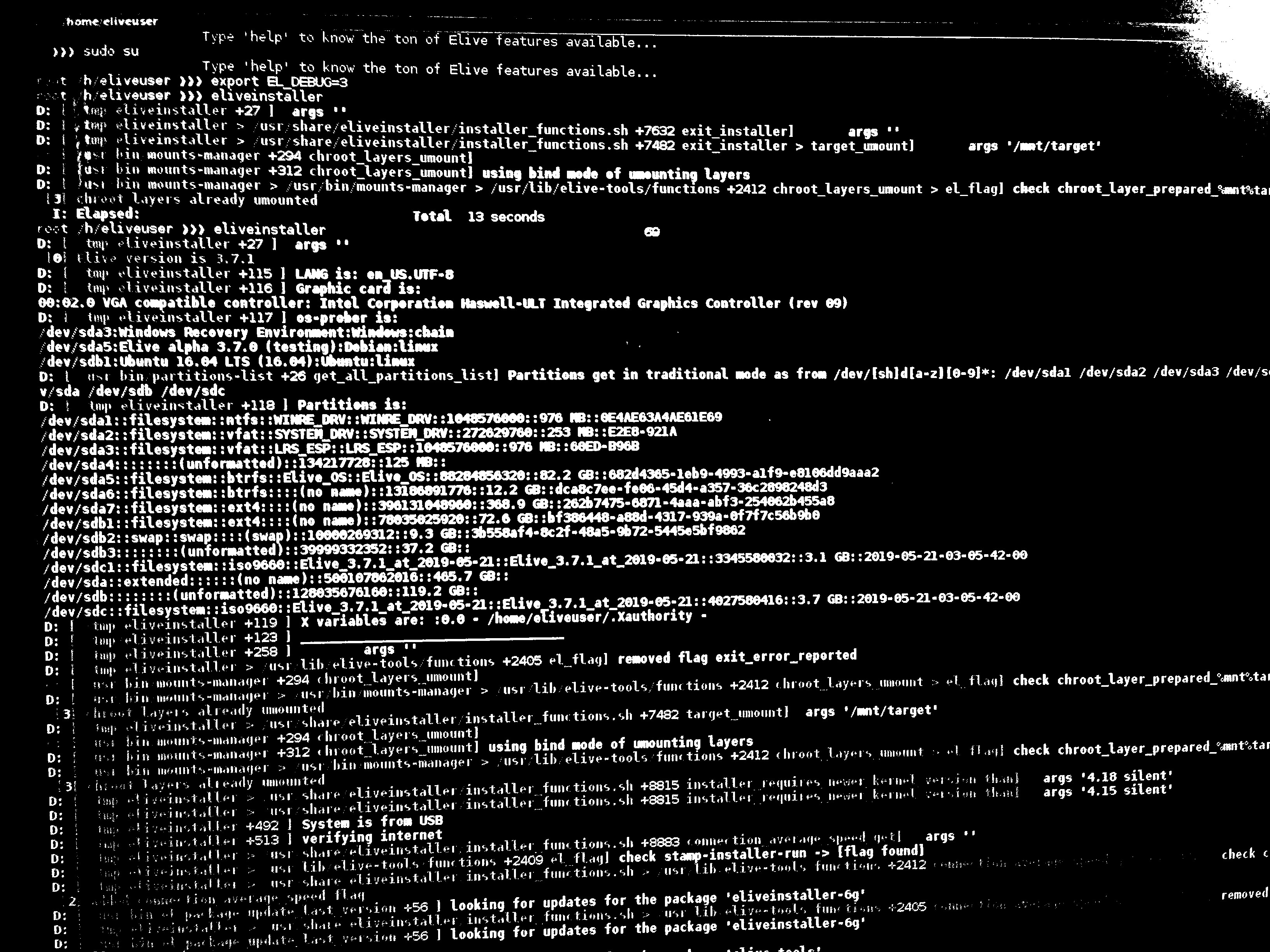

This can be caused by multiple things, we will need to know which steps are doing (like scanning disks maybe, or stuck trying to get internet access, or updating packages)
try:
sudo su
export EL_DEBUG=3
eliveinstaller
will show you more info, maybe there's useful one saying what is doing on that moment :thinking:

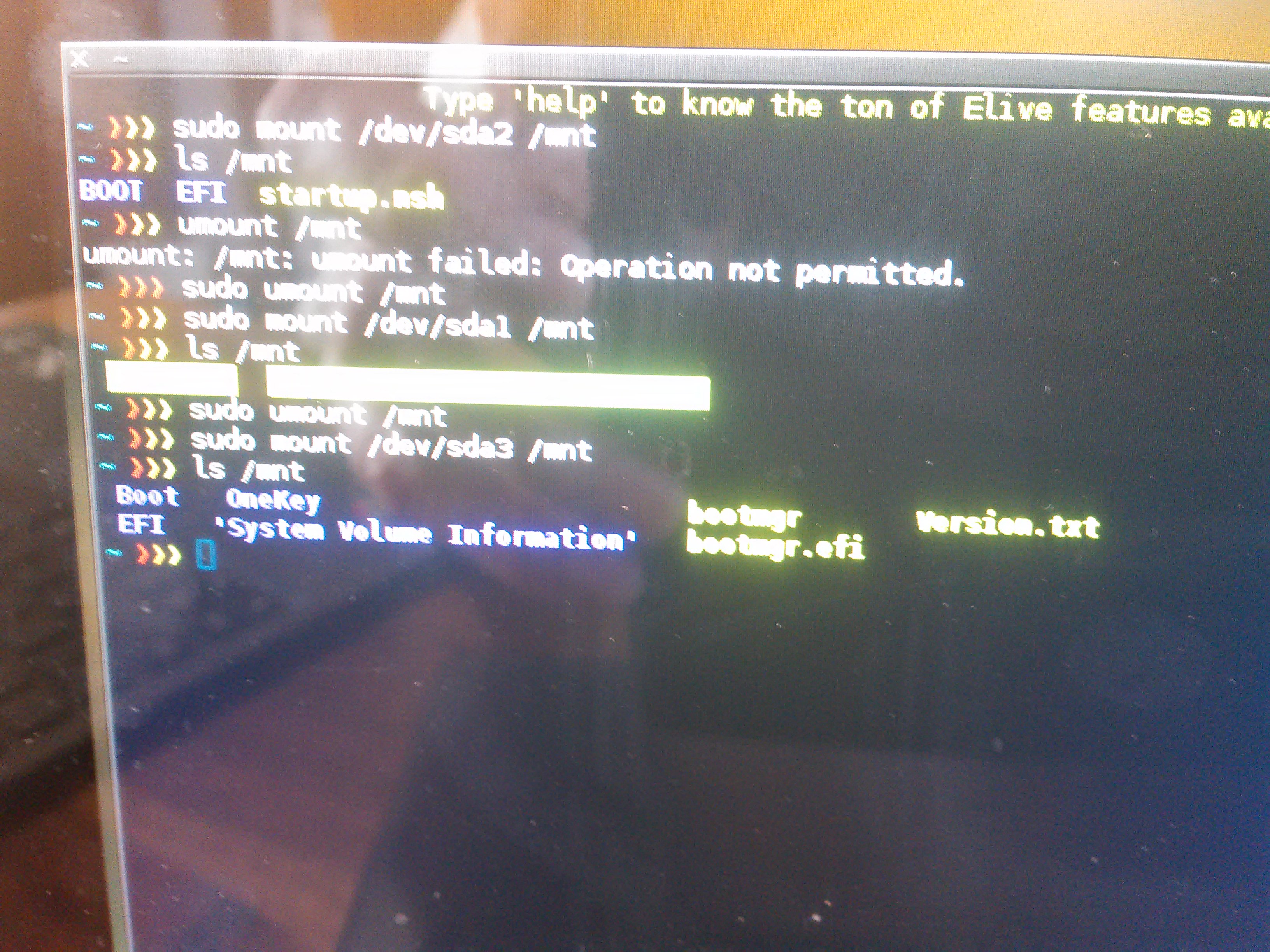

Carrying on I get the partitioner and opt for 2 Reiser4 partitions. Once choosing / partition, installer wants to have a >250 Mb boot partition ...... but actually that's allready there. See Pics of content existing partitions and the selection window.
Me I stop right there as maybe @Thanatermesis wants to see the contents of those partitions first.
Considering sda3 as not so important (who wants Win anayway? :face_vomiting:) I will use tht for the this install, there will definitely be more to come. :excited:
And the contents
BTW: The 2, hard to read yellow blocks say resp. Recovery and 'System Volume Information'
Strange thing, during installation "moving atoms at speed of light" I get a second widget asking me to choose a partition again. I close it and then tells me I've exited the installer though package management continues in the open console. (picture taken of the console NOT of the 2 concurrent widgets)

Booting ubuntu and mounting /dev/sda3 shows the files installed by elive_installer. So that went OK.
Keeping all as is, in case @Thanatermesis wants to see some of the content.

im confused, yes the installer may want to you add a boot partition, yourself (manually), you cannot use the /boot of another system (like ubuntu), mmh where is the problem? :thinking: you mean you already added the /boot partition in the installer and is asking it again?

No I hadn't added a boot partition but there were already boot partitions there as the pics show.
