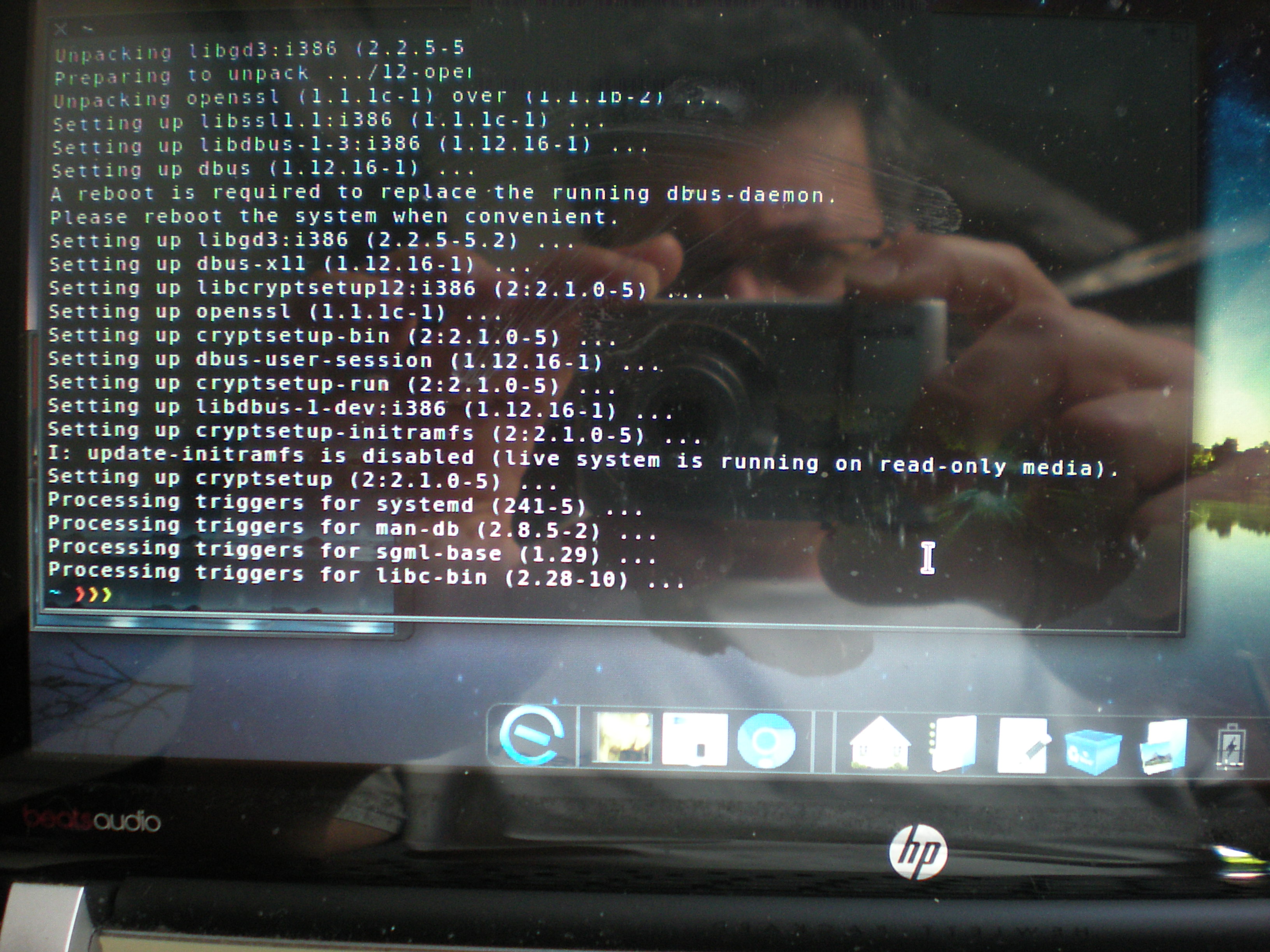

  • Persistence is not available because system says that the USB stick is only in read mode (maybe a USB stick HW failure because I can't had persistence with the some stick when I made first test of 64 bit), Gparted shows a FAT32 partition, but it seems to be R-O file system inside and persistence error message says that it can know the size of file system:
If I run apug the console shows me that I'm effectively in a R-O system:

thats not an error, its a feature, your system is RW in live mode (over layered ram), that message refferes that the update of initramfs file is disabled because is not needed
